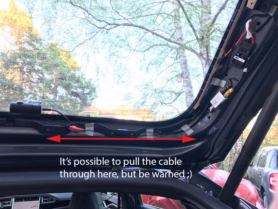

I actually bought that too, but unfortunately it won't work since one of the females from the Y-split only have three cables, and it dosen't match the once you need from the original cable.vinothkannan skrev:Oh thanks Mattias.. I will give a try and wait for your pictures.
https://www.kjell.com/se/sortiment/dato ... tar-p98847
can i use this instead ..? will it work..?
I forgot that i actually taped everything together in an ugly hidden mess, so I'm afraid that the pictures won't help really.

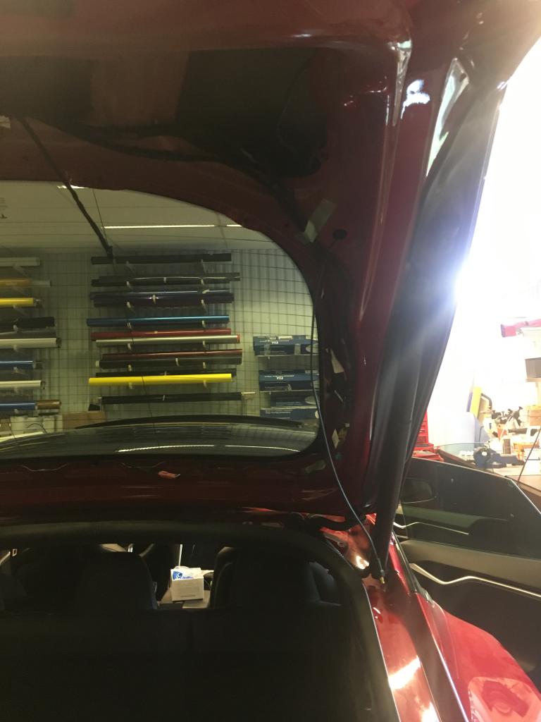

Two things that will make your live easier when installing the rear cam though:
1. Buy spare blue clips, it's very easy to break them when removing the rear trim pieces. SC has them, or you can go with these:
https://www.navringar.se/plastclips/toy ... ps-pl-2064
2. Sand down the rear cable, making it a bit smaller, round and much easier to pull it through tight spaces.
3. Skip the middle clip of the right side trim panel and pull the rear cable through there, instead of going the whole way round the trunk as daerik does. Then you don't have to remove that big trim piece.
If you're lucky, you can pull the cable trough that tiny space that's along the top trim piece in the top of the trunk, but the cable gets stuck very easliy. Mine did, and it was a pain to set it free.

Eller så gör du som jag och borrar ett litet hål bredvid den gula kontakten och tar den därigenom, det förenklar väldigt när bakre kameran ska monteras.

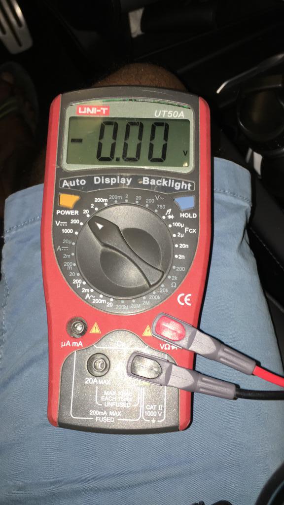

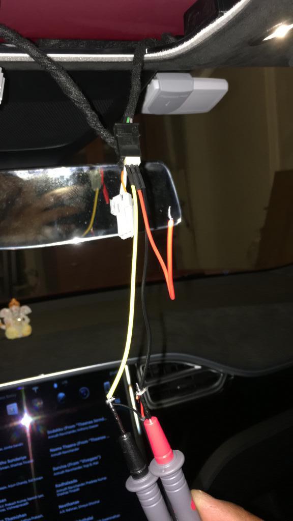

I managed to get the power supply..once and later on i didnt get any 12V power ...Any idea wat cud have went wrong..?
MX100D-AP3-FSD

I have made the connections as per Derek from YouTube. I was able to get 12V once and later I replaced with new wires since I made bad insulation to the wires.
But I don’t get any power for my BlackVue

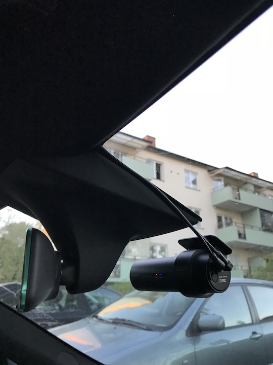

Det här var en ganska trevlig lösning för alla som har en Blackvue. Blir en integrerad och diskret installation!
https://tesland.com/en/product/blackvue ... for-tesla/
Kanske någon här med 3d-printer som kan göra lite business
Här visar DaErik hur man installerar samt hur resultatet blir

FYI.. Mattias.. This is the best way to route the rear cable. without damaging.
MX100D-AP3-FSD
