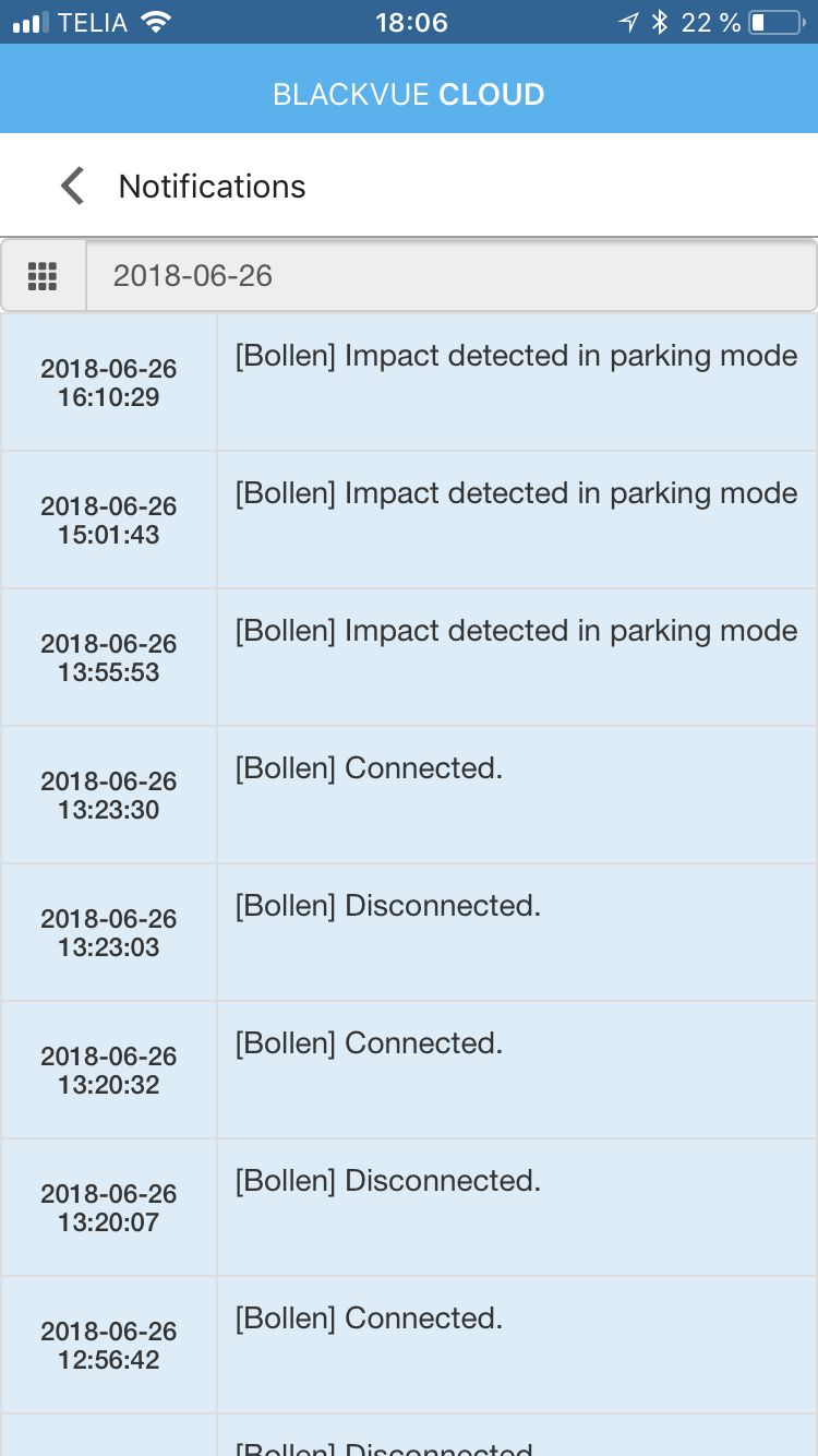

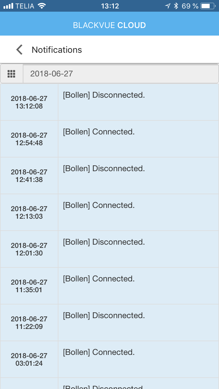

I have mine connected to a wireless router in the car 24/7. With the latest firmware I have started to get disconnects and connects Evert other hour or so. Before it worked flawless...

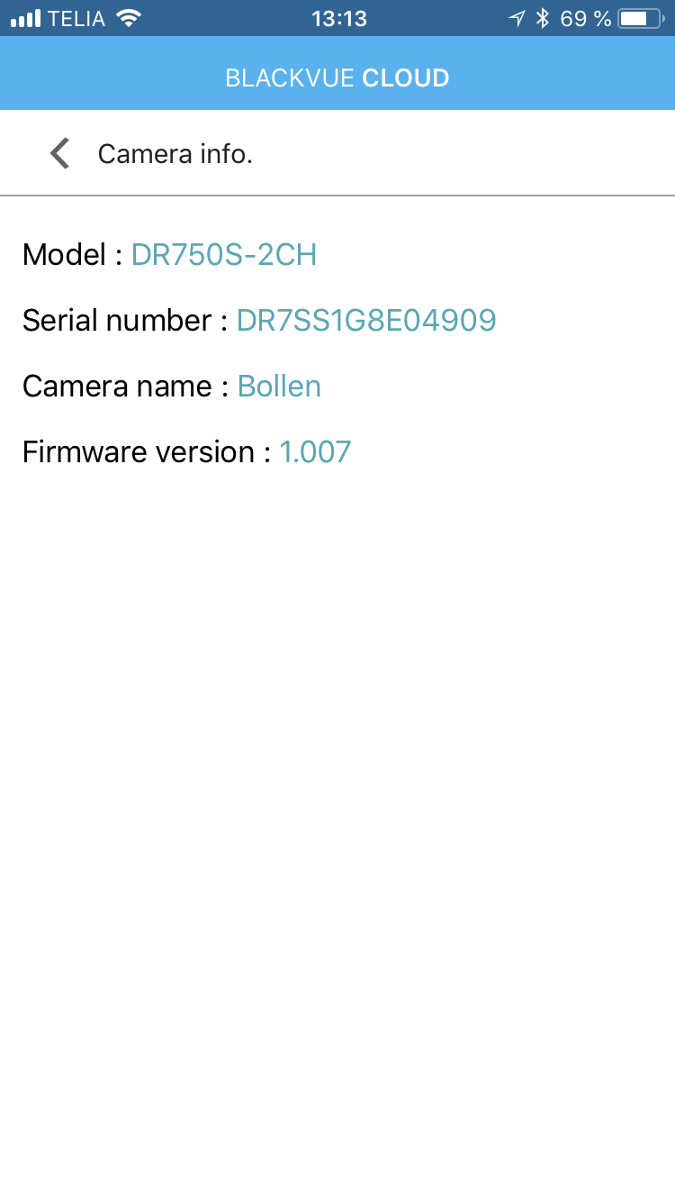

I have 1.007 and still have the connect/disconnect events all day long

I can live with the disconnects for now. It's not a big matter with loss of internet connectivity from time to time. The camera is still recording.

Seem to be less foten now

I think i have the firmware version 1,007.. I will try to check it again.
