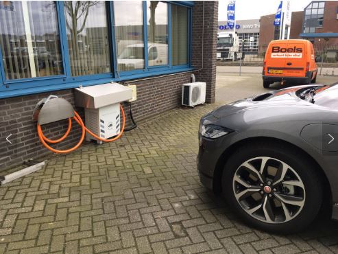

Re: Semisnabbladdare 24kw DC Chademo och CCS
MDCC 22-500
22kW DC CCS
Vikt ca 43 kg
Ansluts till 3-fas 32A
https://www.ebus-company.eu/download/ee ... 22-500.pdf
https://www.ebus-company.eu/european-el ... -e-pkw.php
