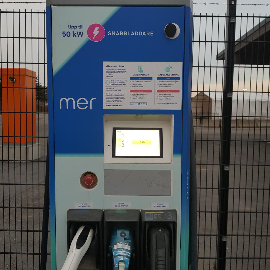

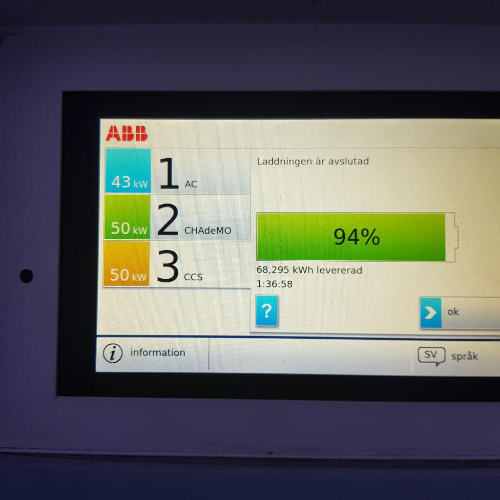

Whilst waiting for our new Model 3 to arrive, I've been checking out charging stations. This one is quite close to home but my question is, which charger will I use? Number 1, 2 or 3? I'm confused :?

M3 and MY uses CCS so you should use no.3

CCS!

You are also able to use no1. But it is slower.

Yes but Tesla M3/MY can only receive 11kW on AC, so don’t get fooled by it saying 43 kW.
AC is normally only used at home or other places where you are not in a hurry.
