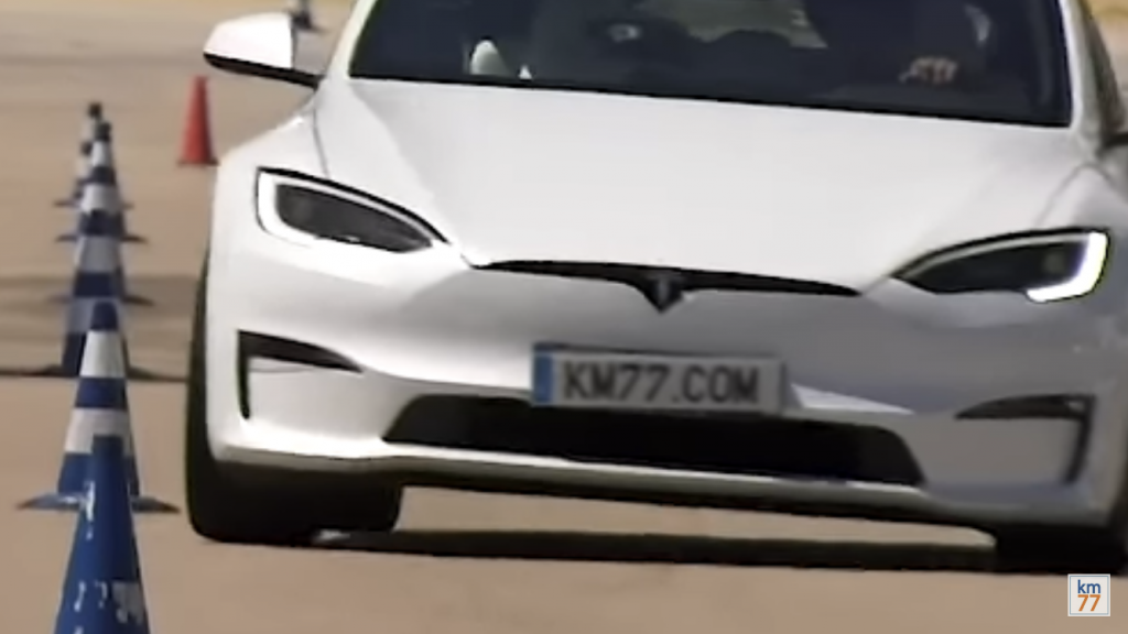

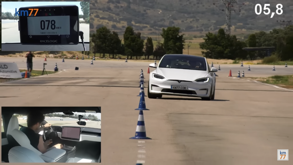

Älgtest av Plaid
Imponerande:
https://www.youtube.com/watch?v=AHjOCJAPhCE
I slalomtestet går den 0,2 sekunder långsammare än Alpine A110, som är en lätt mittmotor-sportbil, och 0,3 sek långsammare än Porsche Taycan.

Första kommentaren till videon:
For the non-Spanish speakers, the tester mentions that the moose test manoeuvre is conducted with feet off the throttle and brake pedals (only steering), and that in this case there’s a significant speed reduction out of the regenerative braking during the manoeuvre (note that the brake light is on from the throttle pedal lift). When the testers realised that the regenerative braking could be disabled on “Track Mode”, they had to leave the track as they were running out of time. The Taycan’s regenerative braking is way less, which explains the lower score. This however doesn’t detract in any way Tesla’s exceptional chassis performance.

Imponerande också att bilens regskylt är enligt Teslas ”Ass designed”
