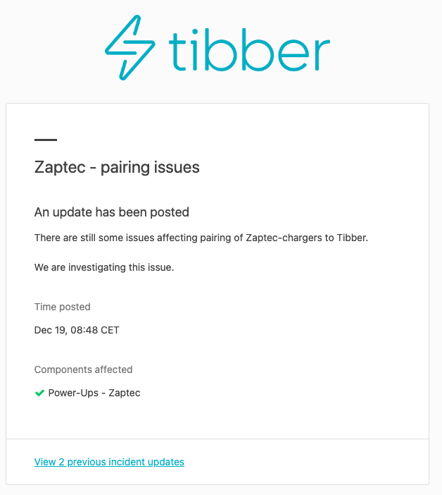

Min son fick samma problem och då svarar Tibber att de har tydligen problem med integrationen av Zaptec Go:

Nu har Tibber fått ordning på grejerna, nu kunde jag lägga till Zaptec som en power up.
Zaptec - Integration and pairing issues
An update has been posted
The pairing issues should now be resolved.
If you have attempted to pair previously, you can now try again.
Make sure Tibber does not already have accesses to your charger in the Zaptec-portal. If yes, you'll need to delete Tibber from the access-list on the charger first and then try to re-pair it to Tibber.
1. Go to https://portal.zaptec.com/login/
2. Find your site.
3. Click on Permissions -> Installation permissions
4. Find Tibber on the list and click the trashcan-icon to delete Tibber.
5. Go to Tibber-app again, and pair the charger to Tibber.
