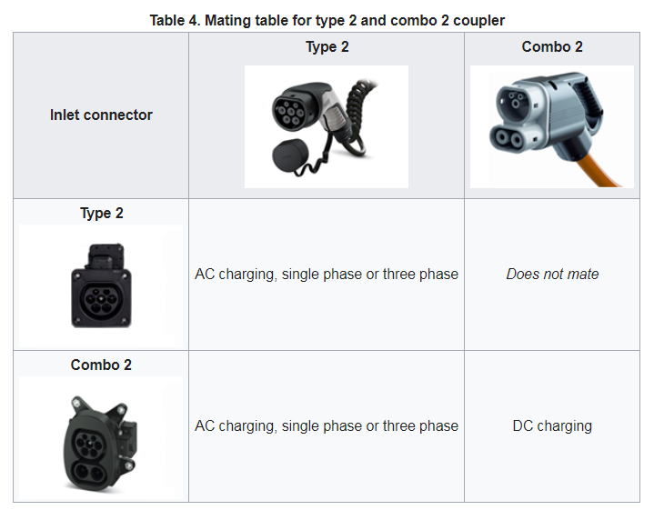

Inlägg av Geni87 »
Men det låter ju oerhört konstigt om de inte skulle följa CCS-standarden??
Från Teslas uttalande angående CCS i Model 3:
"In advance of Model 3 rollout in Europe, we will be retrofitting our existing Superchargers with dual charge cables to enable Model 3 which will come with a CCS Combo 2 charge port, to use the Tesla Supercharger network."
CCS Combo 2 i bilen betyder att den ska stödja Type 2 för AC-laddning och Combo 2 för DC-laddning. SC bör nog läsa på lite.
120kw DC i en typ2-sladd - vilken standard följer dom då? :)
Dom skriver att du kan använda nya kontakten på Superchargern, inget annat.
Geni87
Inlägg: 1728
Re: Har Model 3 3-fas laddning??
Inlägg av Geni87 »
dstr skrev:
Nej, de skriver att bilens laddingång kommer vara av typen CCS Combo 2. :)

No. Model 3 will come standard with a CCS Combo 2 charge port in Europe, which will open up additional third-party charging networks on top of Tesla’s Supercharger & Destination charging networks.
Will Model 3 have access to the Supercharger network in Europe?
Yes, but a CCS connector is required to fast charge. Tesla will retrofit existing Supercharger stations with dual charge cables that are compatible with Combined Charging System Combo 2 and DC Type 2 connectors.
When will a Supercharger be retrofitted?
Tesla is pushing to complete the retrofit of the entire Supercharger network in Europe and Middle East. Completion of a retrofit is dependent on multiple factors, therefore Tesla cannot comment on timing of individual stalls. The navigation in the vehicle will show how many stalls with have a CCS cable for Model 3.
What happens when supercharging M3 with current type 2 cable?
The Model 3 cannot Supercharge with the existing Type 2 cable and requires a CCS cable. Supercharger posts with two stalls are identified with the label Model 3 priority.
How fast can I charge a Model 3?
Model 3 can charge at a maximum of 11 kW on 3-phase or 7.4 kW single phase with any AC charging solution. On a Supercharger, Model 3 can charge at a maximum of 120 kW. The charge rate on 3rd party networks using CCS is not yet confirmed.
Is the 11kW 3 phase AC charging confirmed for Model 3 or will there be an option to upgrade?
Model 3 will have a 3-phase 11 kW on-board charger as standard. There will be no option to upgrade.
Which charge cables can I use for Model 3?
Model 3 is compatible with Type 2 and can charge using the Wall Connector, Destination Charging and any other charging solution with a Type 2 plug, including Mobile Connector.
