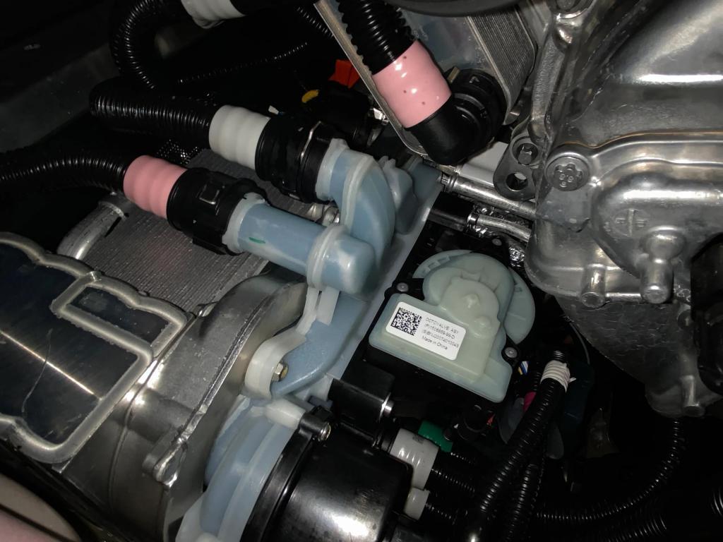

The Tesla Model 3 had the ingenious "Superbottle" at the heart of it's thermal managment system; we are excited to dig into the new "Octovalve". Stay tuned for more.
Octovalve är tydligen genialisk enligt Elon.
Notice that the Condenser is missing in the Model Y. In the Model 3 picture the Condenser is the thing on the bottom attached to the bumper (it usually has a fan on it). The giant cowling in the funk is the radiator.
Basically, the needs are as follows:
Motors: Cold (they only need to be chilled, never heated)
Battery: Heat/Cold
Cabin: Heat/Cold
Radiator: Heat/Cold
Return Flow: Heat/Cold
So as you can see, there are 8 different flows the Octovalve needs to manage (technically 9, but the motors always take cold so it's not really a managed flow). And 2 coolant loops, a hot side and a cold side.
Elon höjer Octavalve till skyarna.
Nackdelen med en värmepump mot ett PTC element är att den är lite långsammare.
Det har man löst med en lokal värmeslinga. Smart!
Yes. PCB design techniques applied to create a heat exchanger that is physically impossible by normal means. Heat pump also has a local heating loop to spool up fast & extend usable temperature range. Octavalve is pretty special too. Team did great work. No credit to me.
Octovalve sparar energi, utrymme, tillverkningskostnader och monteringstid.
