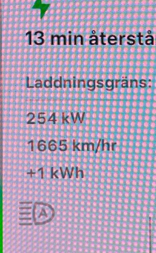

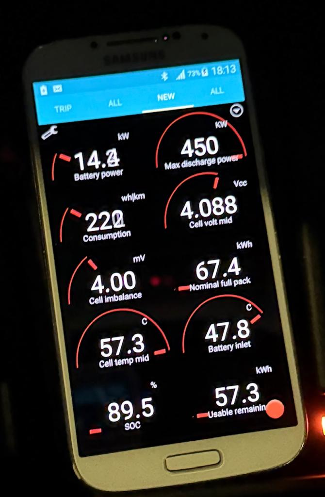

2019 still going strong
Input 254kW
Output 450kW
