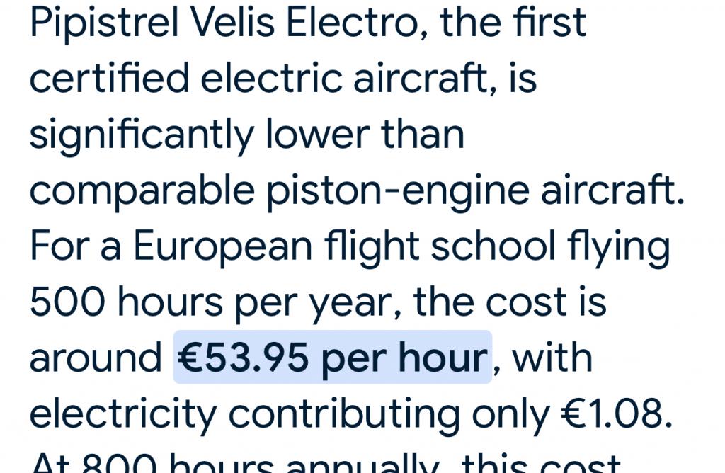

Re: Elflyg
Det är ungefär 600:-/hPipistrel Velis Electro, the first certified electric aircraft, is significantly lower than comparable piston-engine aircraft. For a European flight school flying 500 hours per year, the cost is around €53.95 per hour, with electricity contributing only €1.08.
”The Pipistrel Velis Electro uses approximately 22.76 kWh of electricity per 100 kilometers.”
Man räknar om det till 1.08€ per timme.
20 kWh kostar oftast ….? Om man ska ladda lite fortare.
