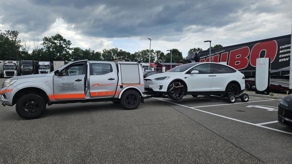

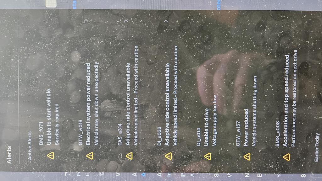

Min 2019 MXP Raven dog under superladdning nere i Tyskland på søndagen.
Ett samtal med Tesla Service bekräftade att HV-batteriet måste bytast (på garantin).
Bilen avvaktar nu transport till Karlsruhe / Tesla SC just nu, vi kom hem i går natt vhja. hyrbil.
Enligt Tesla kan det här ta 4-6v innan jag kan hämta bilen.

Edit: service beskrivningen:
The technician inspected the vehicle and confirmed the "Unable to Drive" alert due to BMS issues.
The issue was caused by a problem with the High Voltage Battery Voltage Sense Harness.
The technician replaced the High Voltage Battery, performed a vitals inspection, and discharged the battery through the discharge port.
After the repairs, the vehicle was tested and the alert was no longer present, ensuring safe operation.
